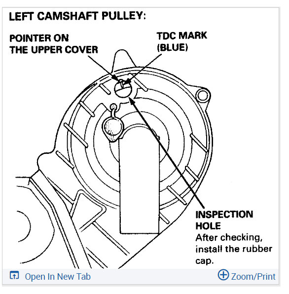

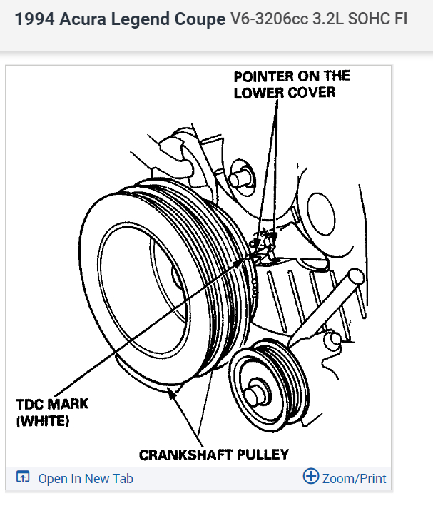

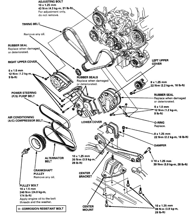

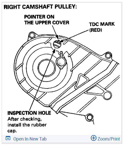

i need guide to install timing belt?
Aug 8, 2009 at 3:05 PM
CARLIFE65
Experienced Mechanic
200 POSTS
i,m sending you this D. this will help you to install belt. and make sure and check that the crankshaft and camshaft pulleys are at TDC.
Oct 19, 2009 at 3:05 AM
55,549 POSTS
Here are the timing belt marks for eh v6 engine. Check out the images (below). Let us know if you need anything else.
