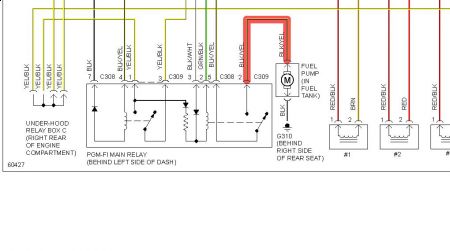

Where is the fuel pump relay located?
Apr 7, 2009 at 9:56 AM
  • 75,992 POSTS
The PGM-FI main relay powers the fuel pump
