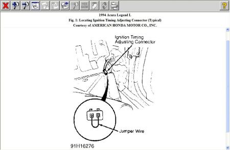

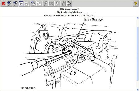

Hi Ming, You can try adjusting the idling speed first. IDLE SPEED & MIXTURE Idle Speed 1. Operate engine until cooling fan comes on. Remove cap from 2-pin connector, located near under- hood relay box. Connect a tachometer to single-Blue wire in 2-pin connector. Check base idle speed with M/T in Neutral (A/T in "N" or "P") and all accessories, including cooling fan, off. Idle speed should be as specified. See IDLE SPEED SPECIFICATIONS table. 2. Connect jumper wire at ignition timing adjusting connector. See Fig. 1 . Check Yellow LED on ECM (M/T) or PCM (A/T), located under passenger seat. 3. If LED is off, idle is okay. If LED is blinking, turn idle screw 1/4 turn clockwise. If LED is on steady, turn idle screw 1/4 turn counterclockwise. See Fig. 2 . 4. After turning idle screw 1/4 turn, wait 30 seconds for LED to go out. If LED does not go out, repeat 1/4 turn (in same direction) and wait 30 seconds, as necessary, until LED goes out.

IDLE SPEED SPECIFICATIONS Fig. 4: Adjusting Idle Screw Courtesy of AMERICAN HONDA MOTOR CO., INC. Idle Mixture IDLE CO LEVEL NOTE: On engines with less than 310 miles, Yellow LED may glow even if idle is okay. DO NOT adjust idle screw on these vehicles. Application RPM Coupe & GS Sedan A/T (1) 580-680 M/T 630-730 Sedan "L" & LS A/T (1) 550-650 M/T 600-700 (1) Automatic transmission in Neutral or Park. NOTE: Idle mixture adjustment is not part of normal tune-up procedure and should not be performed unless mixture control unit is replaced or vehicle fails emissions testing. For idle CO level, see IDLE CO LEVEL table. Application CO Level Legend 0.1% Page 1 of 1 ADJUSTMENTS -1994 Acura Legend L 9/13/2008 The EAVC is attached to the throttle body and to clean it, you can spray carb cleaner into the throttle body with the throttle valve opened.

Me and my uncle did the process that you've explained to us.
1) We checked for any vacuum leaks, there is none whatsoever.
2) We adjusted the idle speed at the EACV based your instruction. The idel speed is set at rpm as of right now.
3) We clean the throttle body by spraying carburetor spray on the inside of the throttle body. The throttle plate was open and not closed. Hopefully that's what it should be. Most cars have a closed throttle plate.
I filled the gas tank on full and was able to drive an additiional 50 miles before it reach to half a tank, then it died again at a stop light. From there on, it dies almost everytime I come to a complete stop when the rpm drops below 500-600 rpm. Sometimes if I brake very slowly then it will stay above the 600 rpm and not die.
