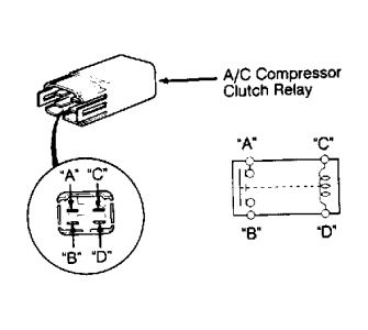

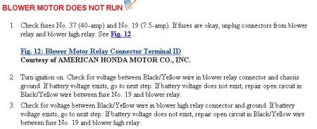

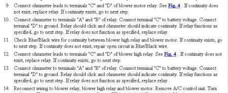

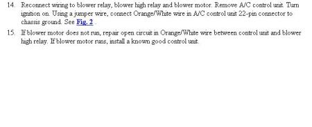

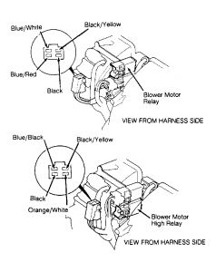

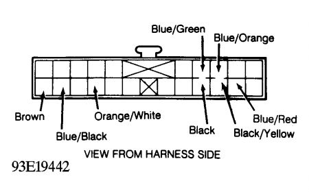

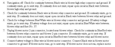

Heater does not come on or blows
Monday, February 23rd, 2009 AT 7:54 PM
ZACKMAN
MECHANIC
4,202 POSTS
Figure 12
Figure 2
Figure 4
