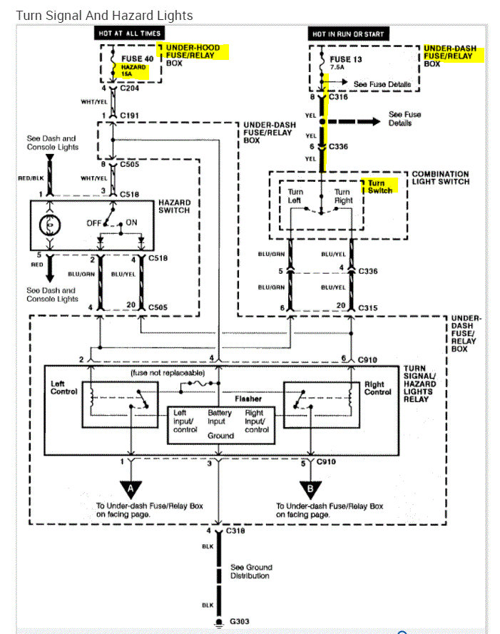

i need to know where my turn signal fuse?
1992 ACURA LEGEND

i have the same problem as the 91 acura with my fuse box but mine is not the same as his. i need to know where my turn signal fuse is but have know idea. chris

The fuse you are looking for is fuse 13. It's located in the fuse box under the dash on the left side.
When you check a fuse, it is important to both check the fuse condition and if power is present to and from the fuse. A fuse can check good, but have no power being supplied to it.
Here is a link that explains how to perform the test:
If you look below, I provided the wiring schematic indicating both the fuse for the signals and the hazard lights. Again, both will be in the fuse box under the left side of the dash.
See pic below.
