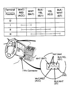

Could you please tell me where the ignition switch is located in this particular vehicle that i have submitted, and how to replace them?

Legend Remove switches from lower dashboard panel. Remove lower dashboard panel. Unplug ignition switch 7-pin connector from underdash fuse block. Using an ohmmeter, check continuity at each switch position. See Fig. 12 . Fig. 12: Testing Ignition Switch (Legend) Courtesy of AMERICAN HONDA MOTOR CO., INC.
https://images.2carpros.com/forum/automotive_pictures/266999_ig_1.jpg
Removal & Installation (Legend & Vigor) Disconnect negative battery cable. Remove switches from lower instrument panel cover. Remove lower instrument panel cover. Unplug 7-pin ignition switch connector from underdash fuse block. Turn ignition switch to "O" position. Remove retaining screws and ignition switch. To install, reverse removal procedure.
