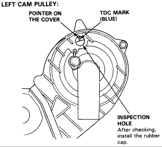

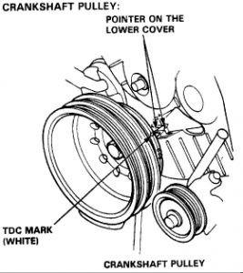

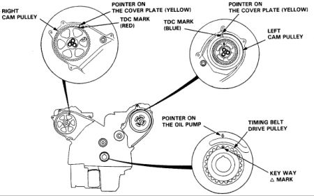

i just need a pic of what timing marks i am supposed to use on my car there are a couple on the cams and crank
Dec 14, 2008 at 12:11 PM
IMPALASS
  • CAR REPAIR CONTRIBUTOR
  • 3,112 POSTS
Hello - I believe this is what you requested. CAUTION: Incorrect removal or installation of the timing belt can result in damage to internal engine components. For complete Timing Belt Removal and Installation information: See: Timing Belt\Service and Repair
