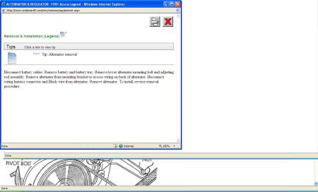

I'm trying to replace the alternator on daughters Legend. Its very tight in there and I would like to know if removeing the air compreesor is rquired to git that puppy out of there. Any tricks or tips would be greatly appreciated.

https://images.2carpros.com/forum/automotive_pictures/416332_1991_acura_legend_alternator_1.jpg
First of all thank you so much for your donation.It look's like the trick is to remove your battery and battery tray.I also emailed you the instruction's on how to remove it.
