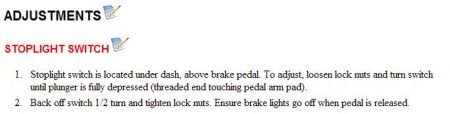

Brakes remain on after the car is turned off and then drain the battery. The sensor pedal is making contact with the sensor, so I assume the sensor needs to be replaced. How do I get the brake light sensor off in order to replace it?

most likely your stoplight switch just needs adjusted, not replaced. try this first...
https://images.2carpros.com/forum/automotive_pictures/261618_Noname_895.jpg
