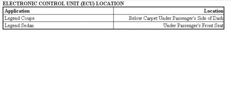

I have bought a ODC 1 Scanner to check for Check Engine Light on my 1990 Acura Legend. But I cannot locate were the ECU connector is on the Car. I have checked both sides of the car inside the Car. Underneath the steering colum and under the glove compartment and also under the drivers seat, but cannot see or find it.

You were close and getting warmer, check the other seat.
https://images.2carpros.com/forum/automotive_pictures/55316_90legendecu_1.jpg
