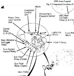

how do i turn off my check engine light. car will not start when light is on. the has been off for the past 2 weeks and car has started and now light is on it will not start. it must be a sensor. how do i locate and reset or change sensor. i bought a obd 1 and it is useless. please help iam low on money.

Hi santibanez, The most common fault with the CEL not turning off during initial ignition ON is the PGM-FI main relay. Remove the relay and check for cracked solders. Resoldering the relay works.
https://images.2carpros.com/forum/automotive_pictures/192750_PGMFIRelay90Legend_3.jpg
If it is not the fault of the relay, then it could be a faulty sensor or the ECM itself. We start with the relay.

SANTIBANEZ
sorry to bug u but one quick questions. the diagram u sent with your response, what is that picture of and where is it located.
Jul 4, 2010 at 1:36 PM
KHLOW2008
  • 41,812 POSTS
Note the PGM-FI main relay location in the diagram.
