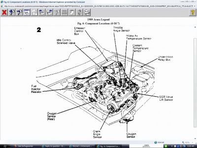

MERLIN2021
  • 17,250 POSTS
Check these systems. EACV, Air intake system, MAP sensor, Crank angle sensor, engine coolant temp sensor,TPS, Idle air control, and my fav, the EGR valve! for stuck open..

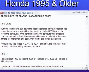

MERLIN2021
  • 17,250 POSTS
The VERY first step is to read ALL codes! Then post them here and I will assist you further...this is how!

DANNY6969
Merlin thanks for responding to my question. are the listed systems and parts listed in the order of which I should check first and could you also tell me how to check each system and part your help is greatly appricated. Could you also add link to diagram or blow it up so I can see it.Any responses from others experencies would also be greatly appricated.

DANNY6969
Merlin as stated in inital question when I turned on ignition and looked at LED there were no codes flashing it flashed once red on left side and once red on right side and that was it.
