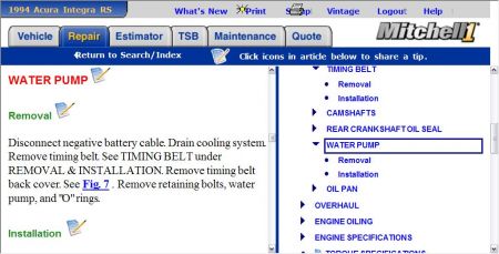

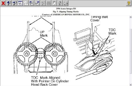

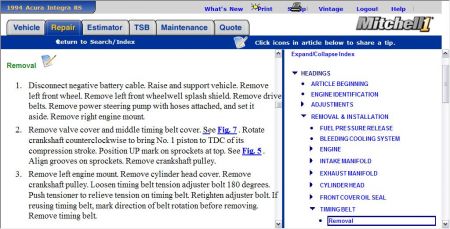

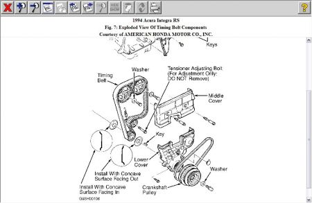

1994 Acura Integra RS 3dr, is leaking coolant under the engine driver side/left tire. I think it's the water pump. Where is the water pump located? How do i replace the water pump and timing belt? What steps should be done to replace water pump and timing belt? what parts are needed (besides water pump and timing belt), gaskets?

See below and good luck
https://images.2carpros.com/forum/automotive_pictures/12900_water_pump_1.jpg
https://images.2carpros.com/forum/automotive_pictures/12900_timing_belt_1.jpg
https://images.2carpros.com/forum/automotive_pictures/12900_timing_belt_2_1.jpg
https://images.2carpros.com/forum/automotive_pictures/12900_timing_marks_1.jpg
