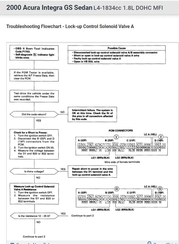

Codes p1753 and p0730/40
2000 ACURA INTEGRA
150,000 MILES • 2WD • AUTOMATIC
MVOIGT
Car listed above is a GS. My car when I first take off will kick into gear but sometimes while driving it will suddenly disengage and act as if it were in neutral. If I'm at a stop light it also disengages. please help
Jun 16, 2021 at 3:47 PM
  • 110,194 POSTS

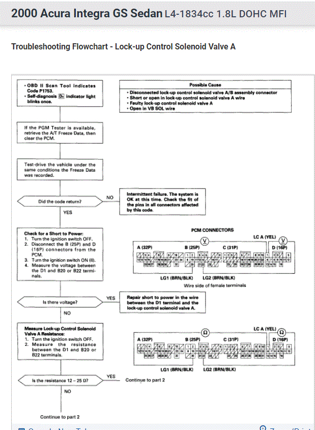

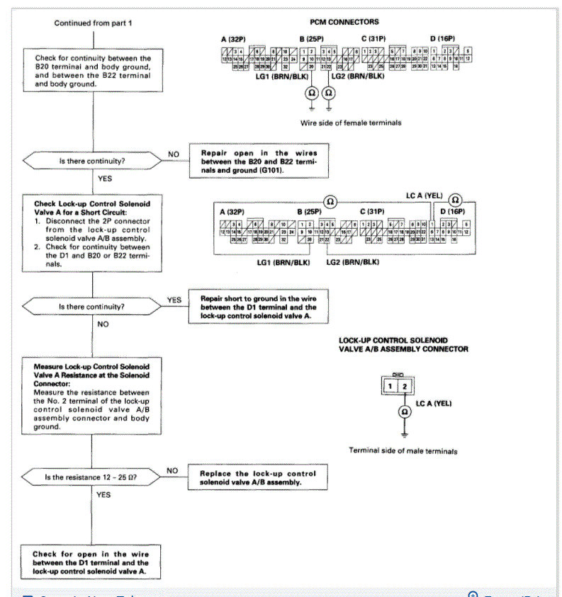

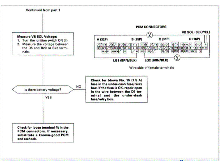

The codes are pointing to a problem with the lockup control solenoid A in the transmission. I attached the diagnostics below specific to code P1753. I'm providing them first. The other codes are related and are likely the result of this solenoid.

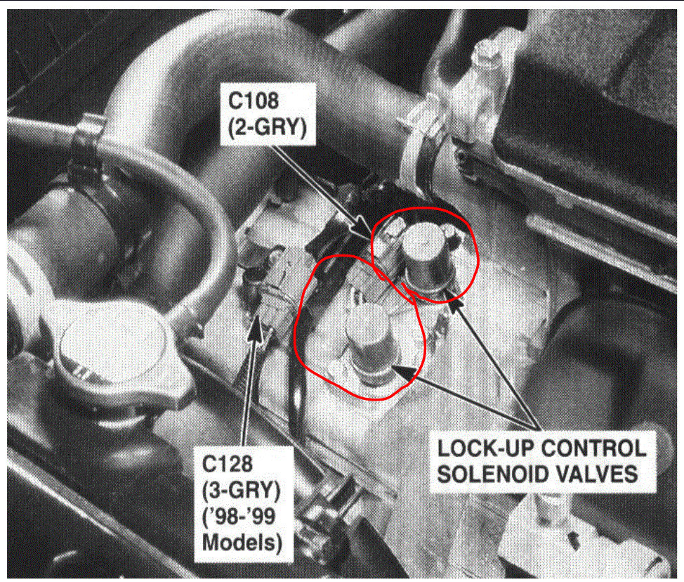

The last pic shows the location of the lock-up solenoid. If you are not comfortable performing the diagnostics, confirm the connectors at the solenoids are connected, in good condition, and not corroded.
Let me know what you find.
