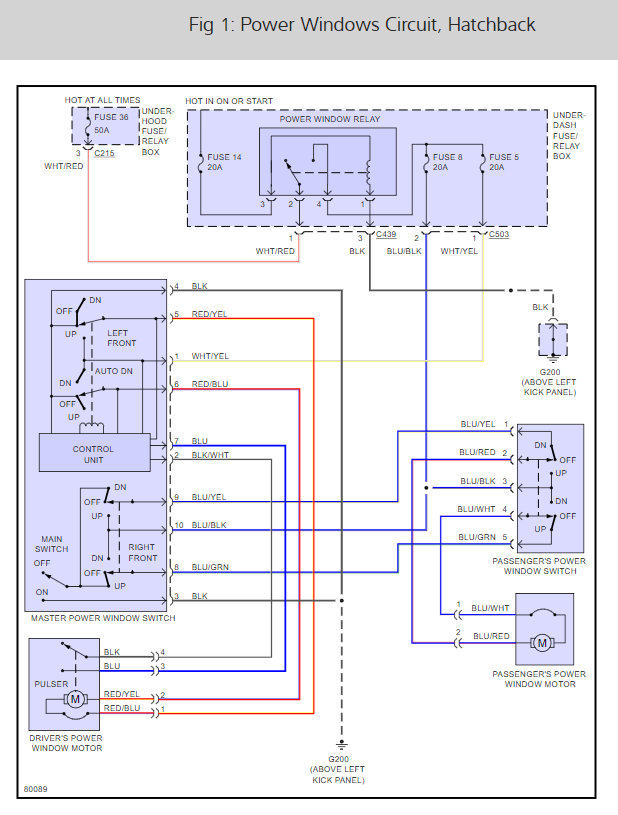

How to test and find the power window relay.
Oct 22, 2009 at 1:39 PM
BRIAN_DEAL

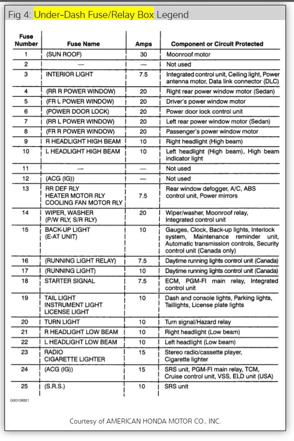

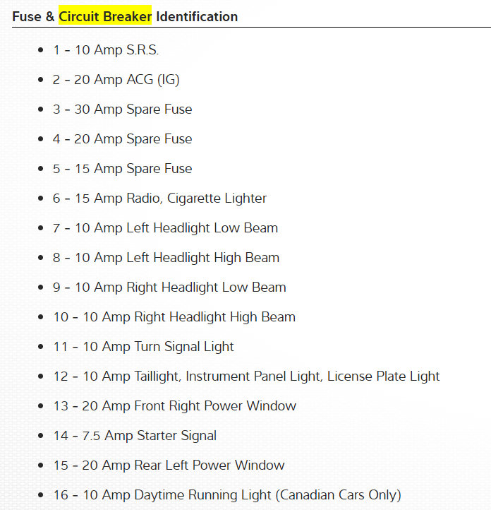

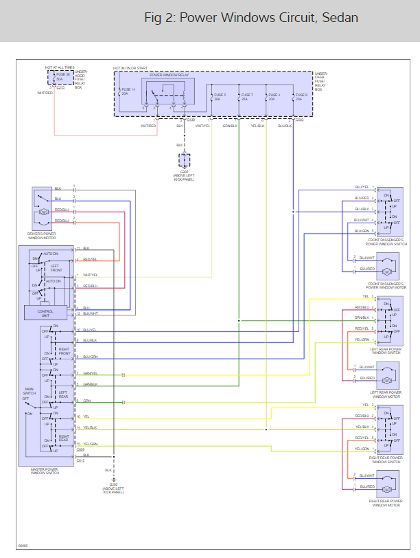

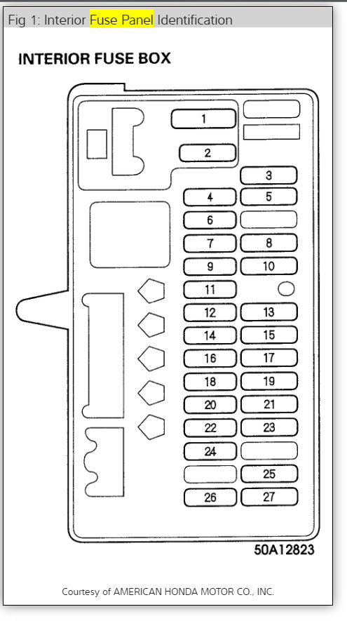

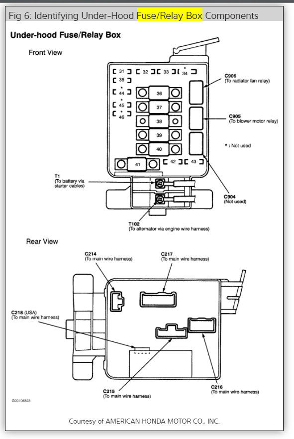

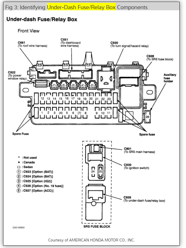

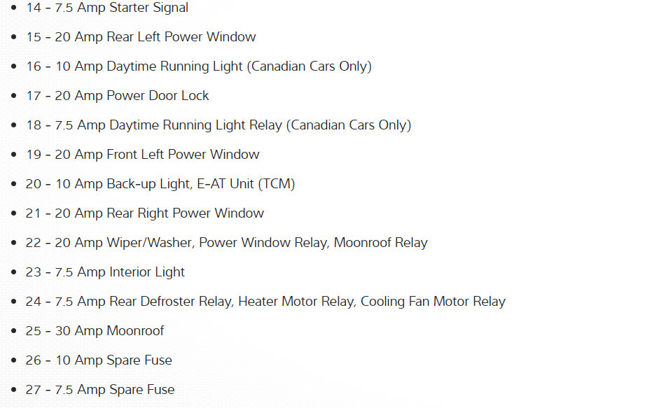

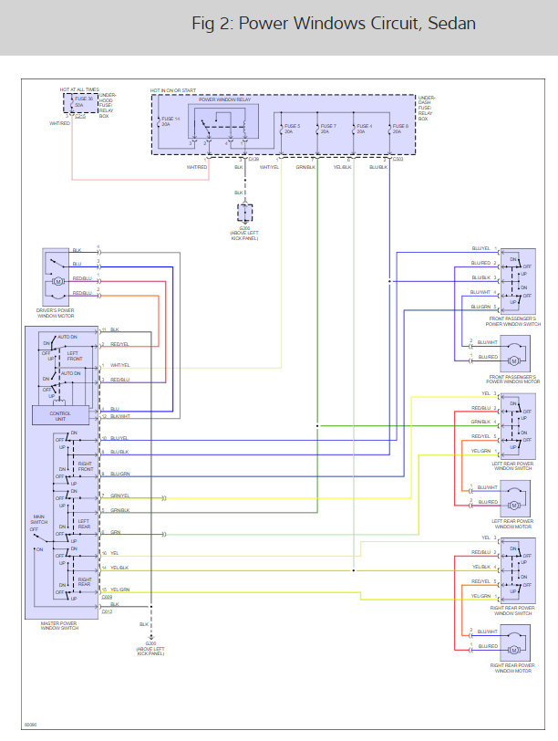

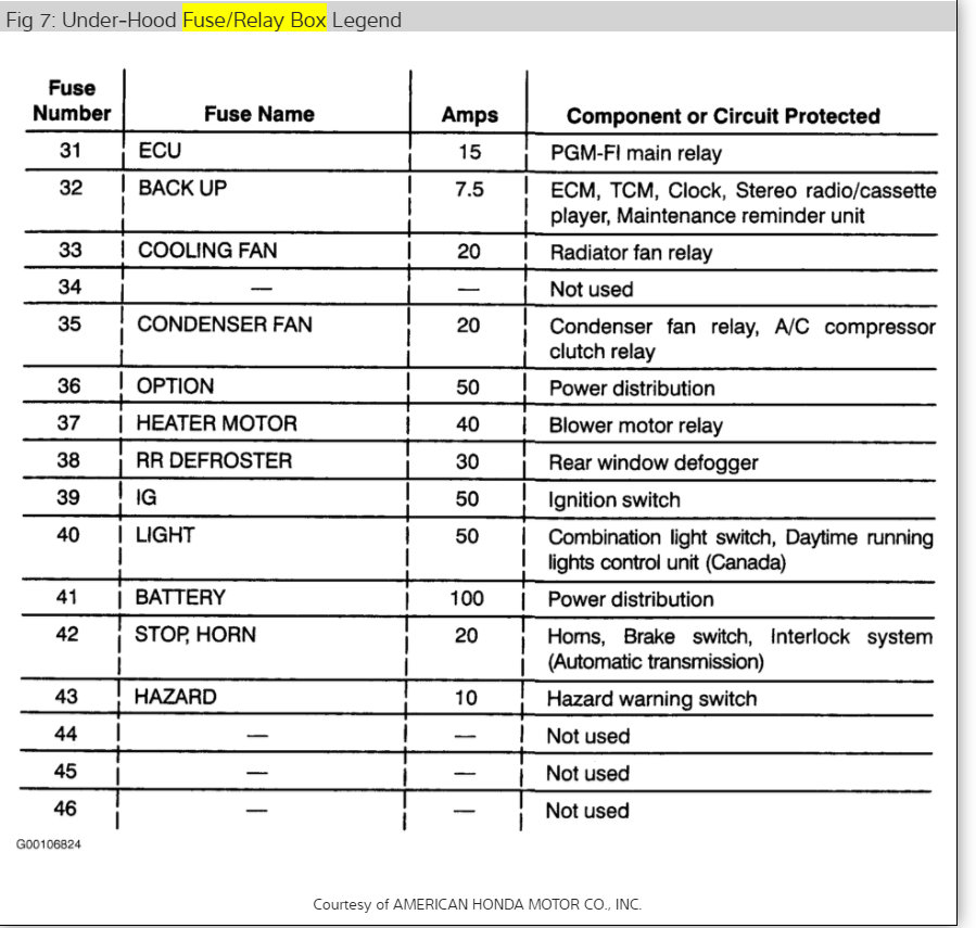

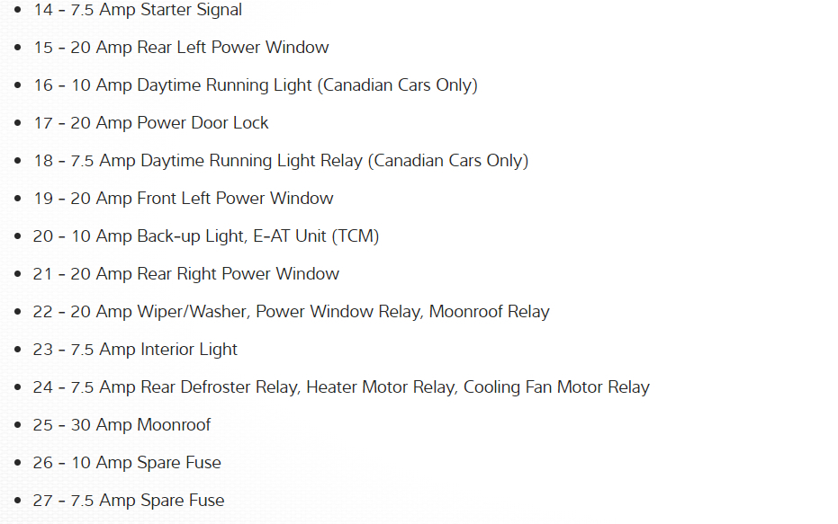

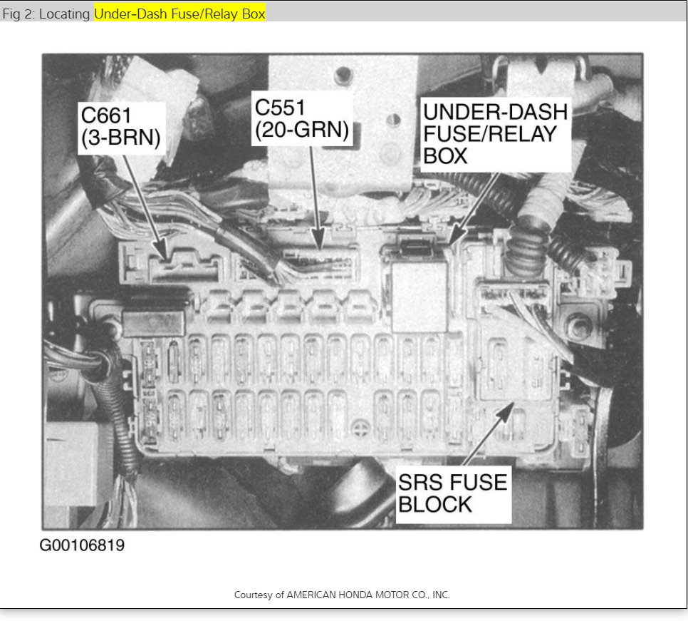

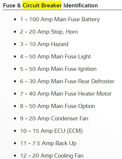

Hello here are guides and diagrams to help you test the power window relay once you find it.
Here are the power window wiring diagrams so you can see how the system works.

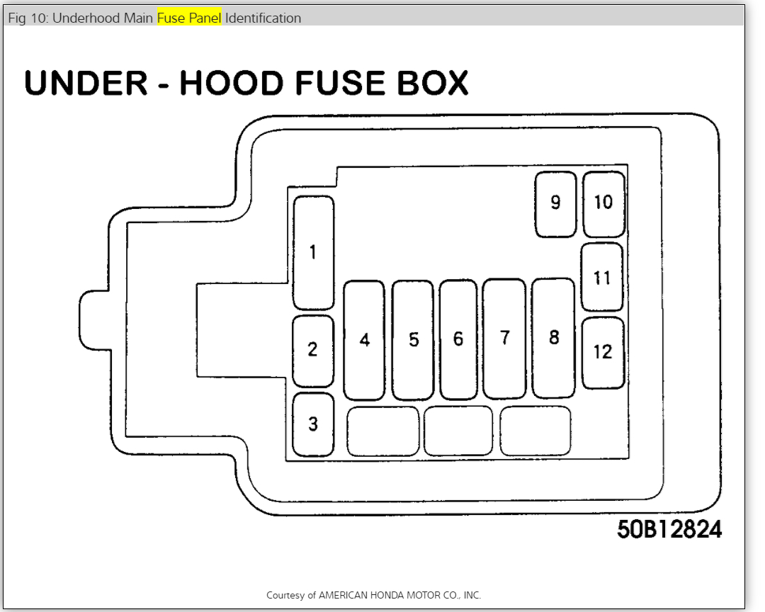

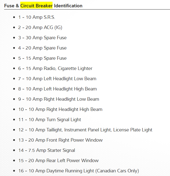

Make sure you check the fuses as well.
Cheers
Feb 3, 2007 at 10:13 AM
CARLIFE65
  • 200 POSTS
Thank you this site is great I relayed the relay now the windows work again ya! I love this site.
