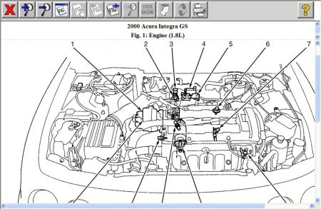

I have a 2000 acura integra ls sedan. After driving the car (say 1hr or two), letting the car rest for about 30min. Then, starting the car, as soon I step on the accelerator pedal (gradually), car does not accelerate for like a second or two. After that brief pause, car then accelerate with a kick. This happens intermittently and only after starting the car.
I've replaced the fuel pump filter, pcv valve, poured a bottle of STP injector cleaner before filling up for gas. And problem still exists. However, I've not cleaned the throttle/choke as of yet.
Any help is greatly appreciated.

Might want to test the throttle position sensor it takes the place of an accelerator pump on a carbuerator-to prevent hesitation- could be a weak spot in it/out of range-

Thanks for the tip. Do you have an idea where I can find that 'throttle position sensor' on the vehicle? I currently don't have an acura repair manual at the moment, but should be arriving soon.

See item No.2 below
https://images.2carpros.com/forum/automotive_pictures/12900_TPS_2.jpg

Excellent! Thanks for the detailed diagram. Will post my results after investigation.
