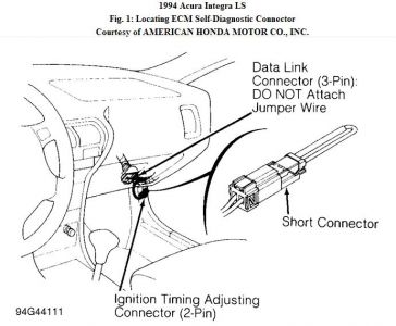

KHLOW2008
  • 41,814 POSTS
Hi yveangel09, Retrieve the trouble code to find out what is wring. However the symptoms seems to point to a faulty ABS modulator unit. RETRIEVING CODES 1 . Turn engine off. Turn ignition on. Ensure ANTI-LOCK warning light comes on. Start engine and check ANTI-LOCK warning light. If warning light goes out, no fault codes exist. 2 . If light remains on, turn engine off. Disconnect service check connector. Connect SSC Short Connector (07PAZ - 0010100) to service check connector. ( A jumper wire or papar clip would do )
https://images.2carpros.com/forum/automotive_pictures/192750_SCS94IntegraLS_1.jpg

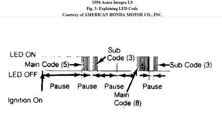

3 . Turn ignition on, but DO NOT start engine. ANTI-LOCK warning light should start flashing Diagnostic Trouble Codes (DTC). 4 . First flashing sequence indicates main code of DTC, and second number indicates sub code of DTC. See Fig. 3 . A one - second pause separates main and sub codes. Total of 3 DTC's can be set at one time. There is a 5 - second pause between DTC's.
https://images.2carpros.com/forum/automotive_pictures/192750_ABSCodeReading94IntegraFig03_1.jpg
5 . To recheck DTC sequence, turn ignition off for a few seconds and then turn it back on. After codes are retrieved, go to appropriate test under TROUBLE CODES to diagnose system. The modulator unit is listed at $1735.15. .
