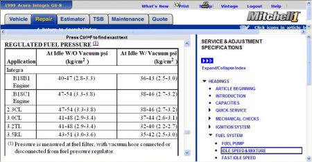

need to perform a fuel presssure test, but first i need to know what are the specs / numbers (psi) for a properly running GS-R>?
thanks-

https://images.2carpros.com/forum/automotive_pictures/12900_fuel_pressure_10.jpg
