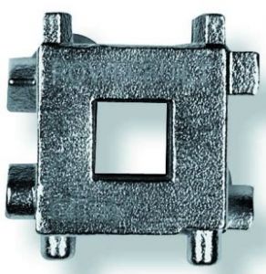

When replacing the rear brakes do I need any special tools

Yes you do. You will need need rear piston tool to twist the piston back into the caliper. This one is by Powerbuilt Tools PN 648410
One of the sides will fit into your piston holes.
