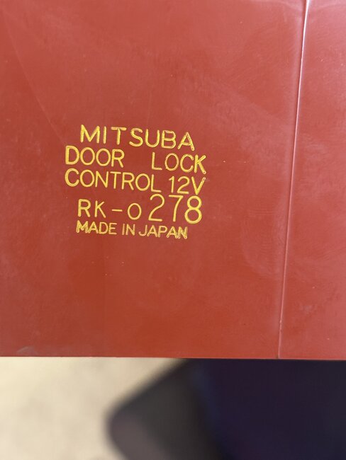

This is the door lock module you need to get, it may be hard to find a new one and use ones are relatively cheap, just make sure to do a little research on it so you know you’re not just buying crap… only ones I’m seeing are on eBay

Well, I figured that if it was a car without keyless entry, you turned the driver side door key, and this module unlocks all the doors… so if you add an aftermarket alarm for keyless entry, all you’re doing is adding something that just sends a signal to this module. If the actuators work, then all I can think of is a relay of some sort going bad ( how the other lock actuators operate by finding ground) well, the relay that we are speaking of is inside this control unit… gonna order one and replace and see if it remedies the problem

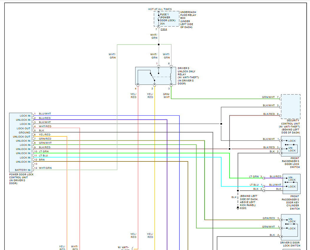

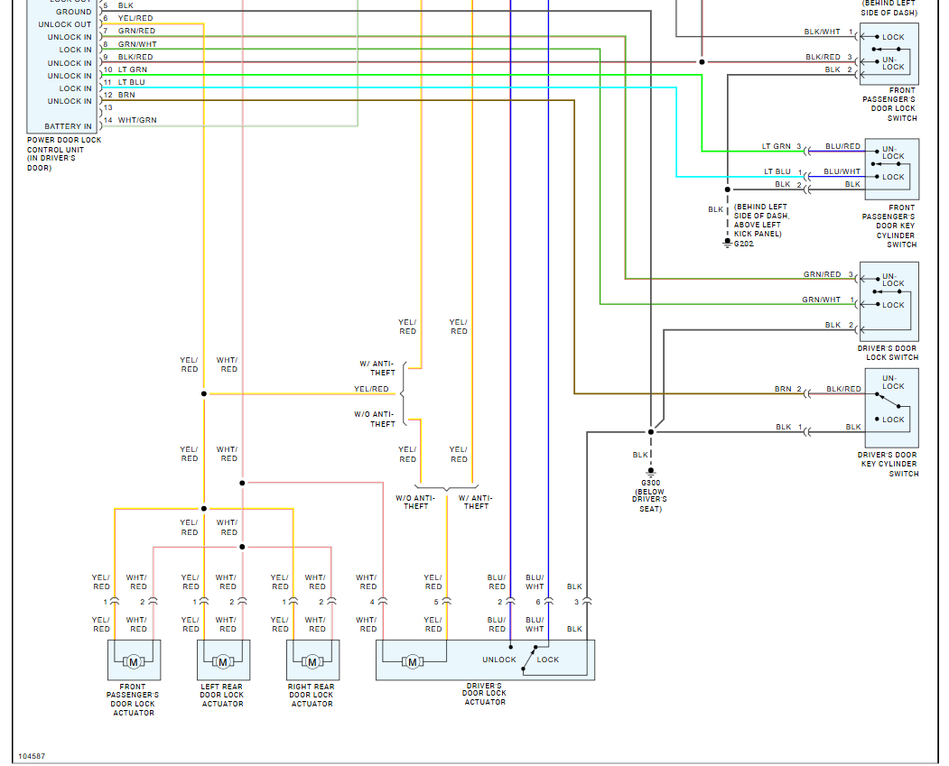

Yep, good call, that should fix it. Here are the wiring diagrams so you can see how the system works and a guide to help with the testing.
https://www.2carpros.com/articles/how-to-check-wiring/
Check out the images (below). Let me know what you find.
