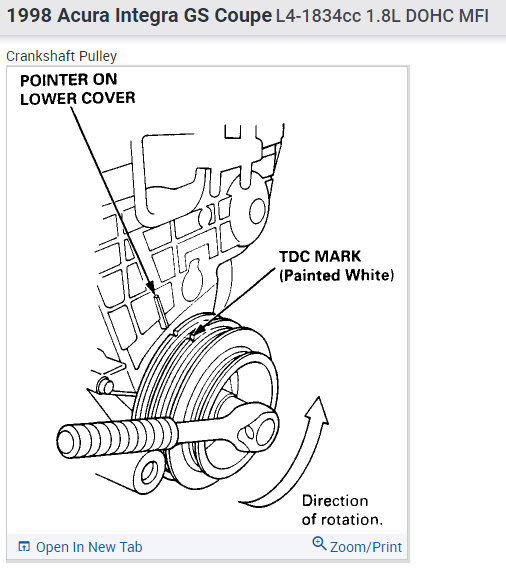

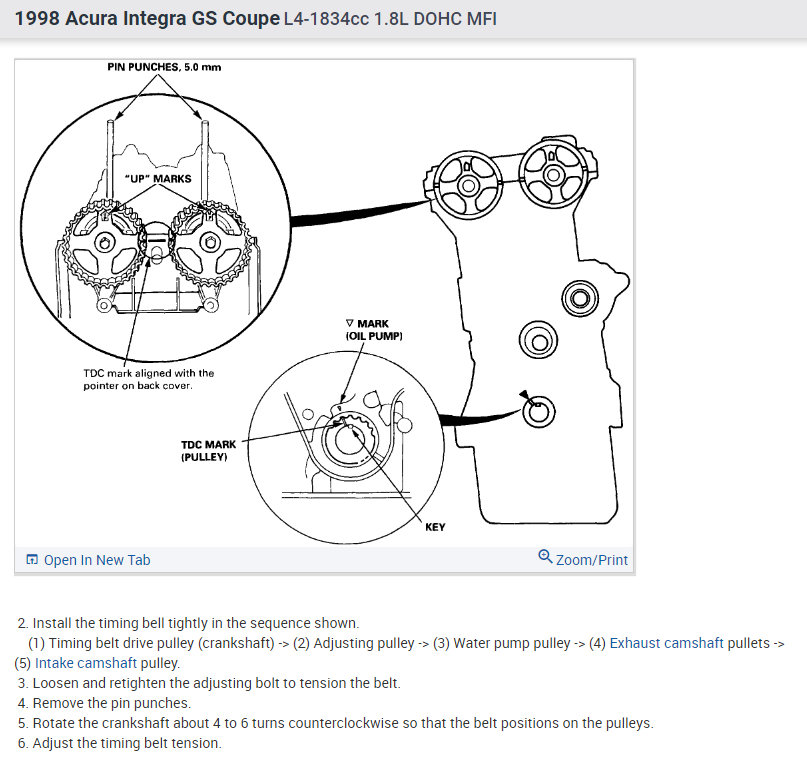

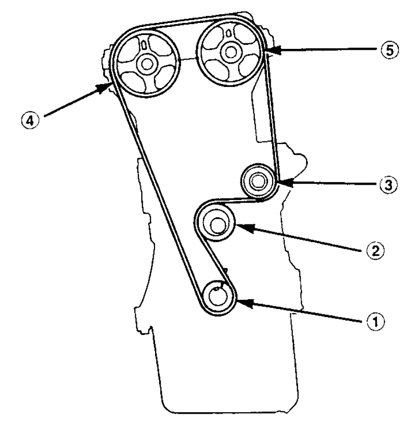

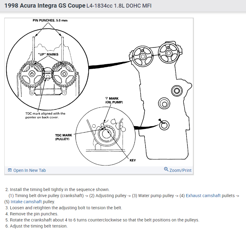

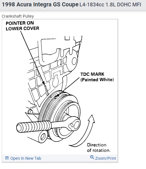

what position are the timing chain marks for cam shafts.
Dec 14, 2008 at 7:34 AM
SQM
  • 6,383 POSTS

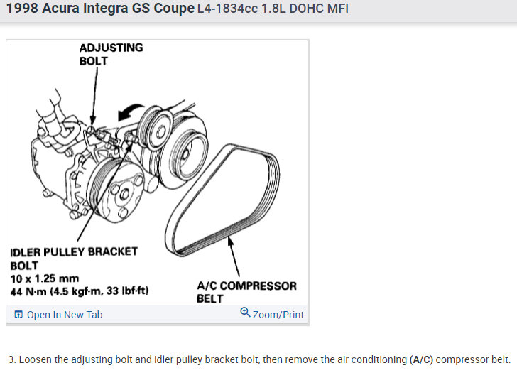

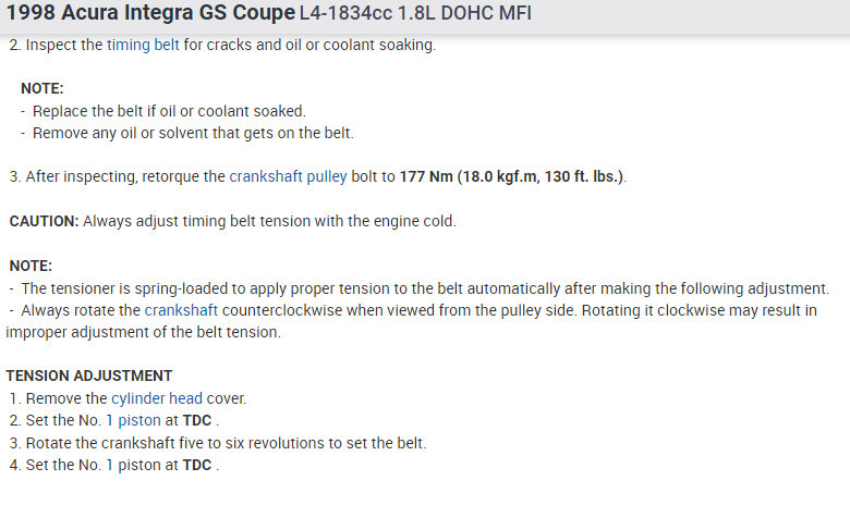

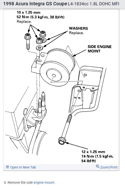

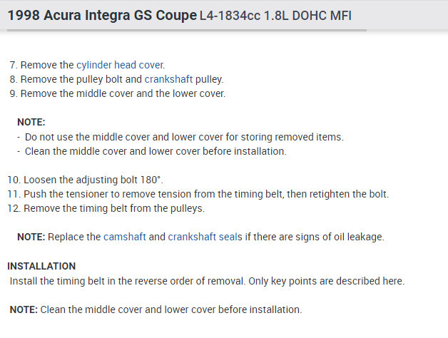

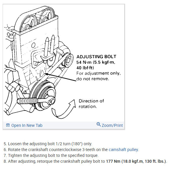

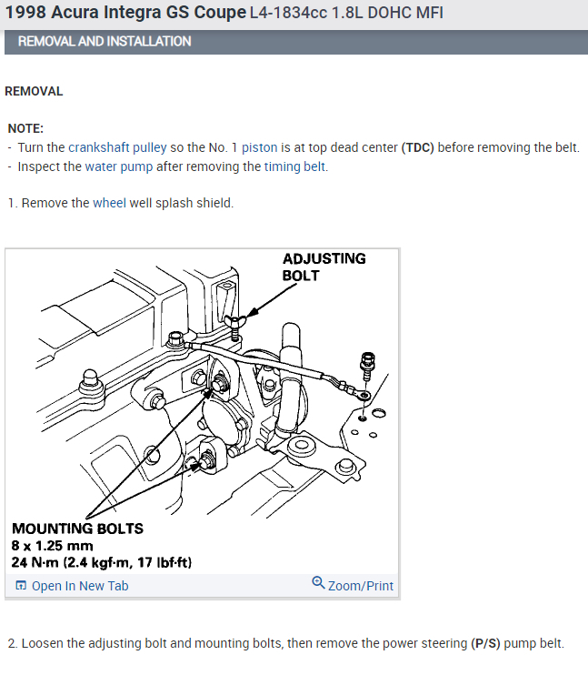

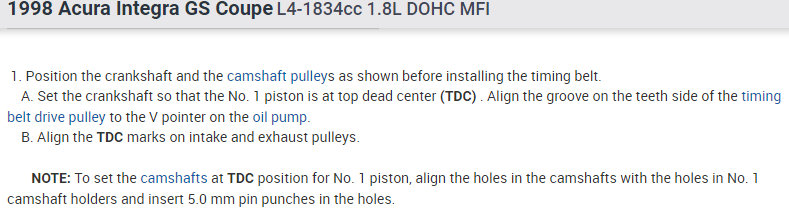

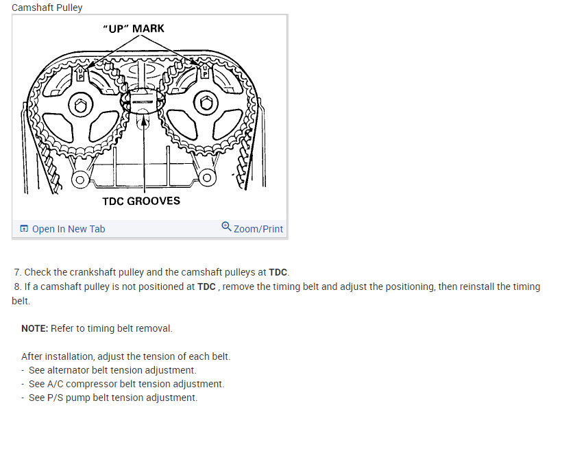

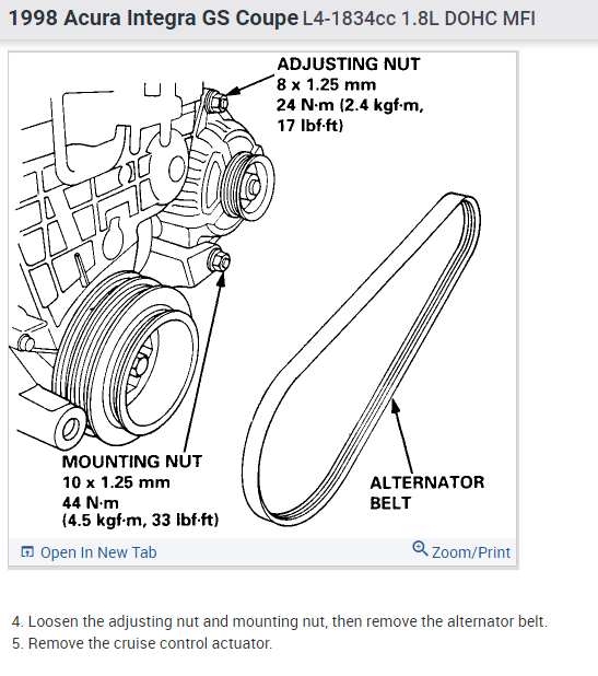

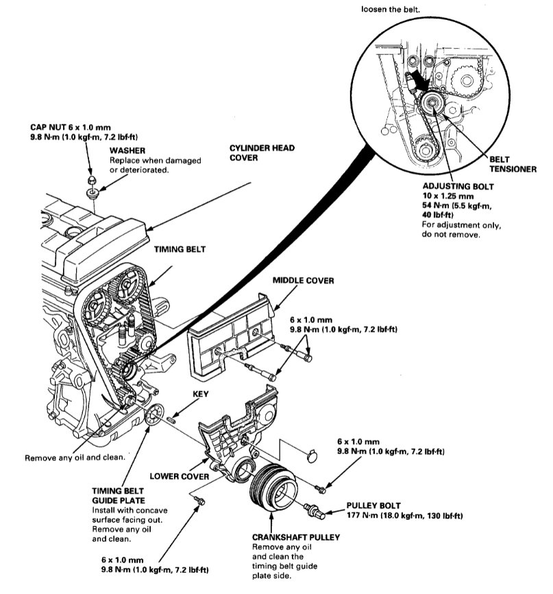

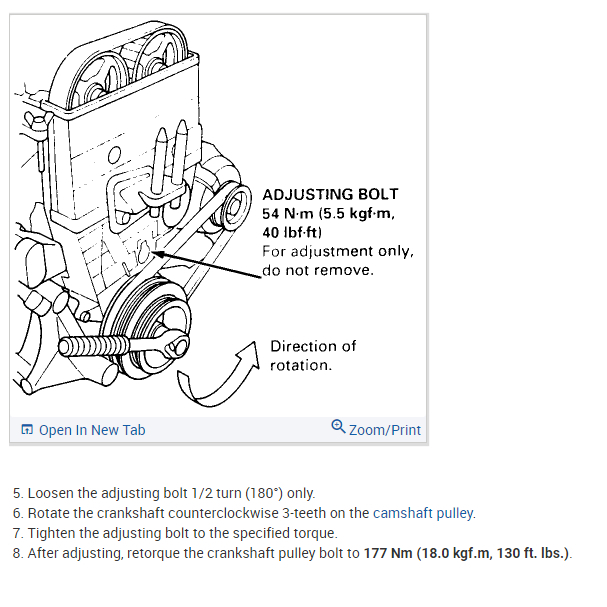

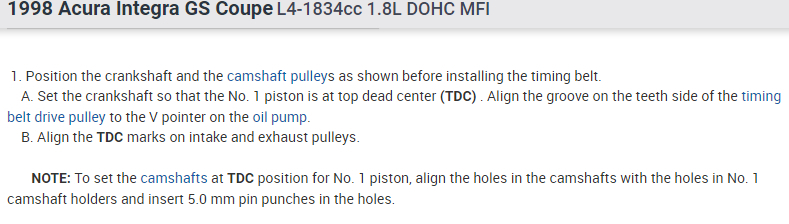

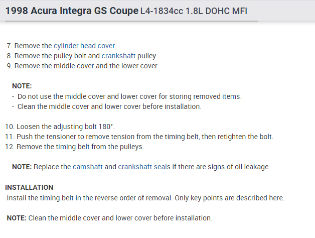

Before taking off the belt you need to make sure that number 1 cylinder is at TDC.

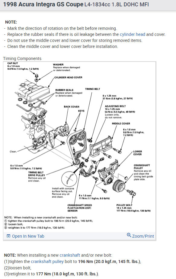

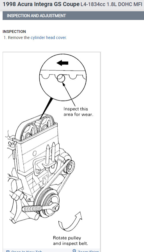

I have attached all the diagrams showing the timing marks for your reference.
Be sure to have everything lined up exactly as the diagrams.
Engine might not run properly even if you are off by just one notch of the belt.
