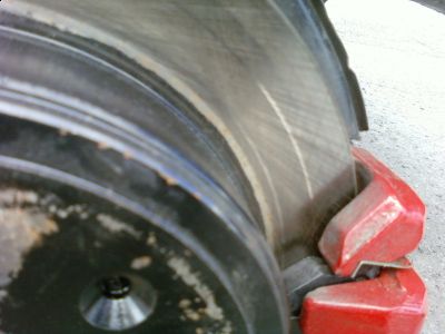

rear left brake make a lot of noise. My new pad put a large Strach on my new rotor. When I spin the wheel pad gives himself shots on my rotor.I got the noise only at low speed .There is noise, even if I press the brake pedal or not.

BUSSIE
  • 42 POSTS
brake pads brushes against the rotor, because the anti spring rattle does not do a good job on the brake pad.

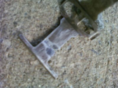

My rear anti rattle spring was cracked :
https://images.2carpros.com/forum/automotive_pictures/311311_rat_2.jpg
I destroy the old anti rattle spring with a jackhammer and I put a new. All noise was terminated. problem solved ,thank you very much
