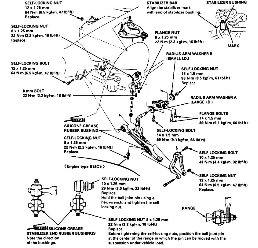

Hi i am going to Chicago for Cristmas. but befor i go i want to know what should i check on my car to have a great trip? the timing belt was replace with the water pump when the car had 100k. i took the car to acura delarship and got a obo tune-up at 110k. lower ball joint is need it. should i replace both and what is the cost?

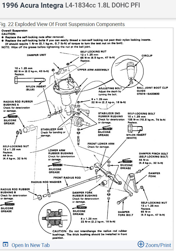

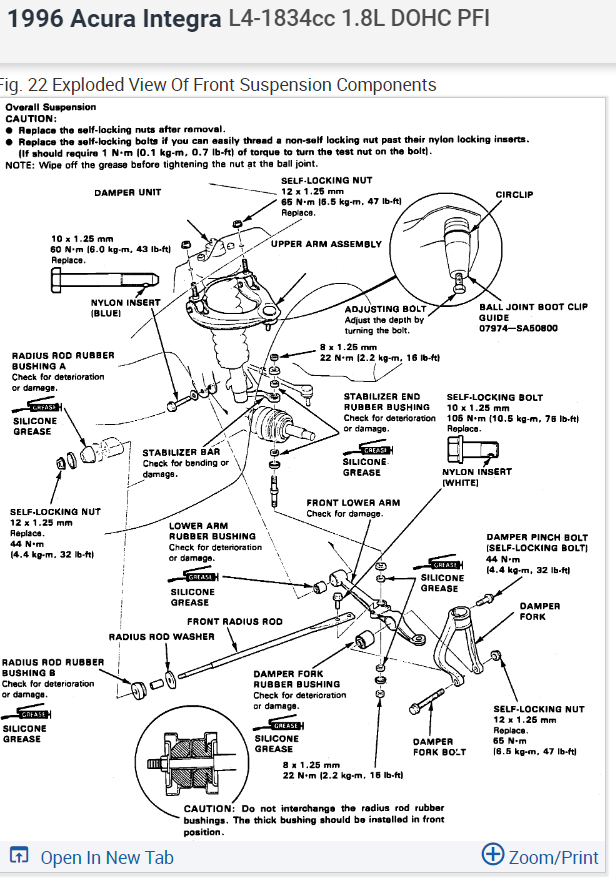

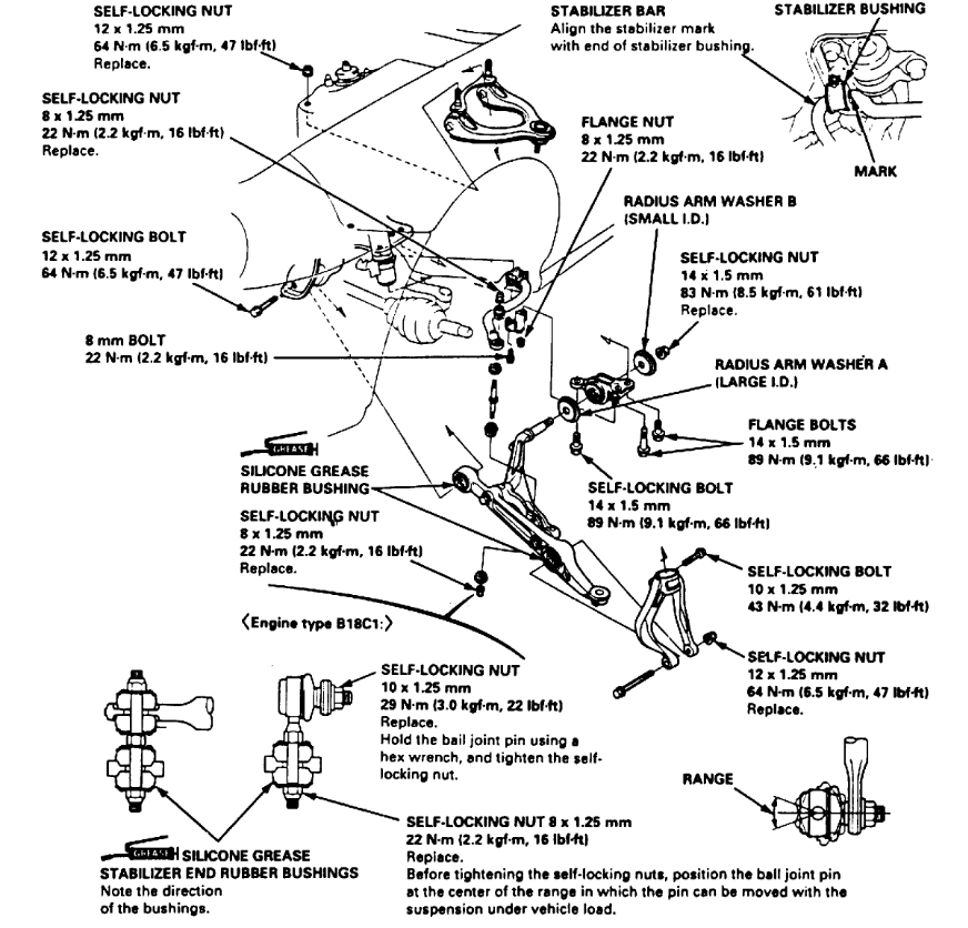

Yes I would change them both out, here is how the job is done which will cost about $450.00 to have it done. Here is how to do the job yourself if you want to save some money.
Here is a generic guide to help you step by step with instructions in the diagrams below to show you how on your car.
https://www.2carpros.com/articles/replace-ball-joint
Check out the images (below). Let us know if you need anything else.
