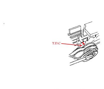

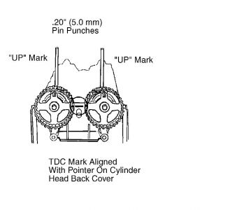

Can I find top dead center on cylinder one after repairing any damage and when replacing the head or do I run a chance of f-en it up again? I ask because the mechanic I took it to (before I decided to do it myself) already removed the timing cover, belts and distributer. I appreciate all your help.
Thanks,
iggi
Mar 31, 2008 at 10:10 AM
BMRFIXIT
  • 19,053 POSTS
HERE IS THE TIMING MARKS after installing all turn engine by hand few turn making sure you have the timing on correct may I suggest a manual too it will guide you through the process best of luck jack.
