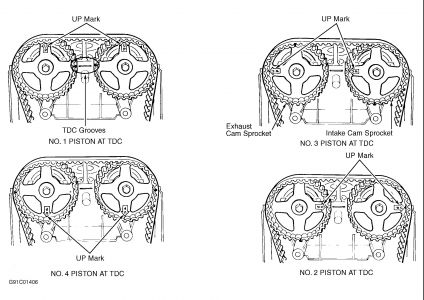

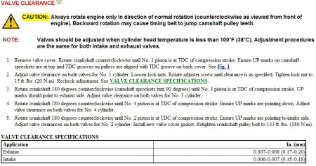

I bought the car from one of my friends. He raced the car with pretty much no oil in it. and now the engine makes a loud tapping noise when the car is idling and gets worse when the car is driven. the engine is a DOHC VTEC B18C1. thanks...u guys are awesome!!
Aug 8, 2008 at 6:47 PM
MHPAUTOS
  • 31,937 POSTS
Hi there, If you have not already, change the oil & filter and use a good quality engine flush, check the valve clearances as well, i would also check that the oil pressure is ok at hot idle, start here. Valve clearance info below. Mark (mhpautos)
https://images.2carpros.com/forum/automotive_pictures/61395_Noname_1.jpg
https://images.2carpros.com/forum/automotive_pictures/61395_Graphic_23.jpg
