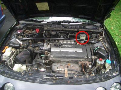

where is the brake fluid reservoir in a 1995 acura integra? is it ok to add brake fluid without bleeding the system or anything? [img:747828a9fe]https://www.2carpros.com/forum/automotive_pictures/299145_n530377451_941414_9316_1.jpg[/img:747828a9fe]

Circled. And, yes. It is OK to add without bleeding. If you are low on fluid and it is not leaking, I would check the brake pads. They are probably thin, and need replacing soon.
