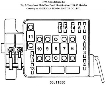

My acg fuse keeps blowing in the car. It has an engine swap in it and the wiring harness is kinda jacked up. It was like that when I bought it. But I'm wondering if my alternator is bad or maybe if there is an open wire causing a short. Help!

Is the fuse box similar to the one in the diagram?
Which numbered fuse is blowing?
Dose the fuse blow immediately upon replacing or does it blow intermittently?

I'm sorry but I don't see a diagram... It just shows little diamonds. But I know for a fact it is the acg fuses. According to my fuse panel it is the acg fuses. I have 2 of them. I can unplug the large wire in the fusebox under the hood going to the alternator and it'll start right up. It blows immediately after I turn the key on with new fuses installed when I have that large wire plugged up still. So I'm assuming it's an issue with the alternator or the wiring going to it...

Sorry for the delay in responding. Somehow I did not receive any notification. Sorry for missing out on the diagram.
https://images.2carpros.com/forum/automotive_pictures/192750_FuseHood95IntegraFig02_1.jpg
I need to know the exact fuse so I can get the necessary information pertaining to the fuse.
