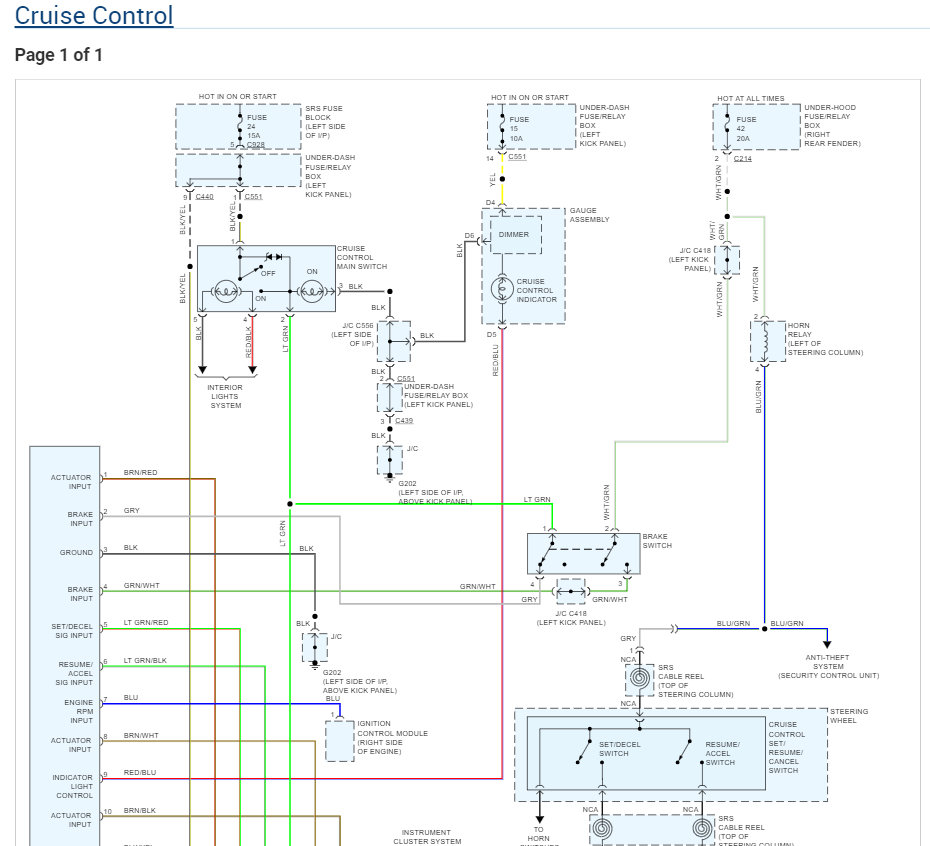

My cruise control went out. Where is the solenoid, and or fuse?
Jan 24, 2009 at 2:08 PM
BLUELIGHTNIN6
  • 16,542 POSTS

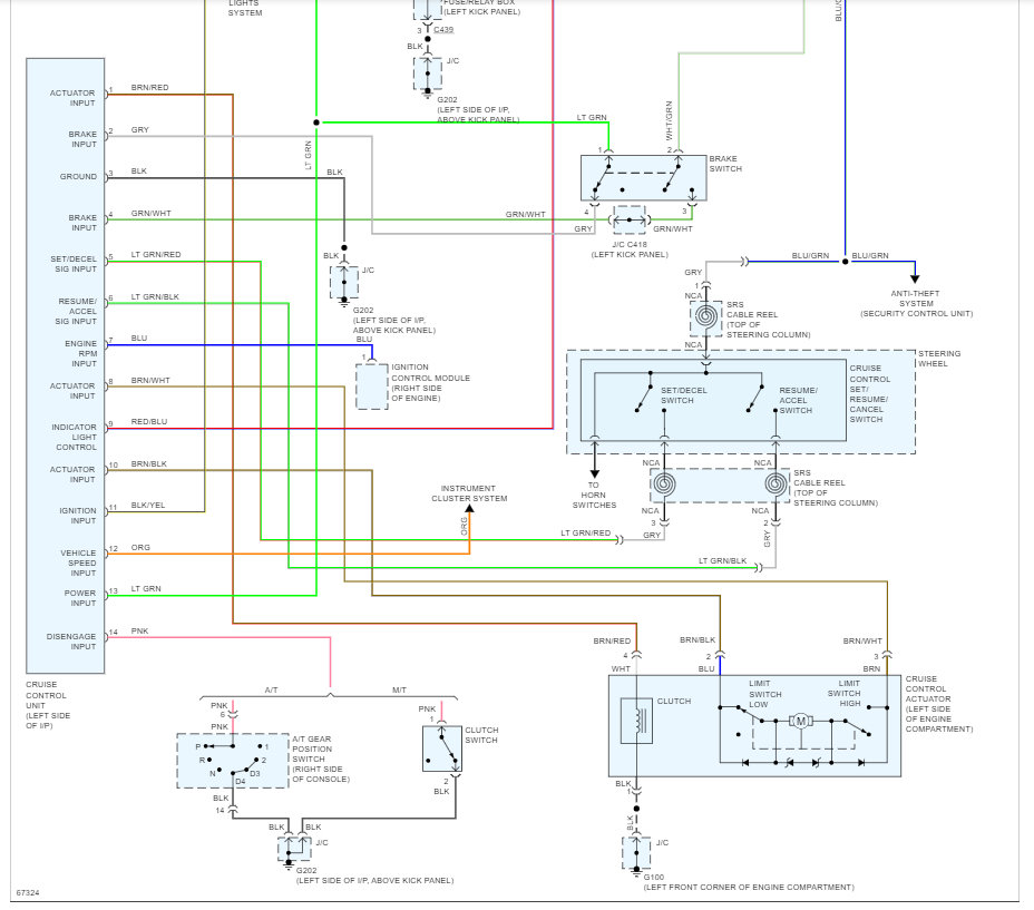

There are two fuses, but I would check the fuses brake light switch and clock spring through the steering wheel which can break causing the cruise control not to work anymore. Here is a guide the the cruise control wiring diagrams to help you fix the problem:
