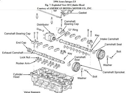

okay i got an b18b1 cylinder head that i bought. Everything is dissambled. One thing i need to know is how to put back the rocker arms? i dont know if they need to be snap into the bolts or not??? Im not sure . help?

Hi ringeeleng, Here is an exploded view of the cylinder head components. The rocker arms are seated on the valves and the pivots with the camshaft seated over them before the camshaft bearing caps are installed and tightened.
https://images.2carpros.com/forum/automotive_pictures/192750_CylinderHead94IntegraFig07a_1.jpg

so there's no need to push in the swivel joints on the rocker arms? rocker arms can just be seated is that correct?
