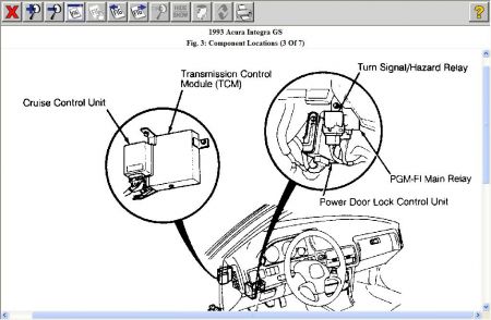

I have a question about the fuel pump relay on the 93 acura integra my question is exactly where is the relay locatied at on this vehicule?

Hi VincentS89, Honda refers to the fuel pump relay is as the PGM-FI main relay. It is locate under left side of dash, left of steering column.
https://images.2carpros.com/forum/automotive_pictures/192750_PGMFIRelay93Integra_1.jpg
