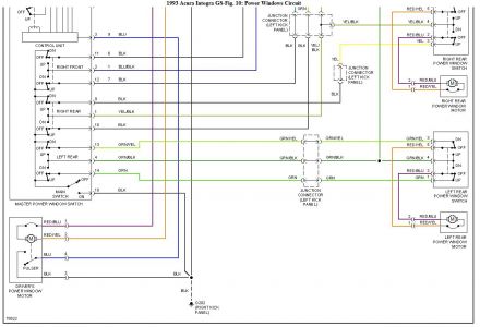

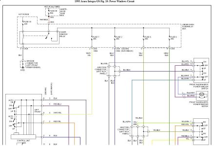

i recently encountered a wiring problem with my windows. the wires for the plug got put in the wrong spots so now what worked before is not now i use to operate both windows from master driver switch now can only operate driver side need a picure or detailed explanation on where the wire need to be put back in order inside the plastic plug end. or some help with the wire diagrams i have basic haynes repair manual schematic doesnt help with wire position on 9 pin switch.need to know where they are supposed to be if doesnt work then i know i need new switches for the third time.

Hi diablodog, Here is a schematic of the power window wiring. Can tyou explain to me what is it that you do not understand?
https://images.2carpros.com/forum/automotive_pictures/192750_WindowCircuit93IntegraFig10a_1.jpg
https://images.2carpros.com/forum/automotive_pictures/192750_WindowCircuit93IntegraFig10b_1.jpg
