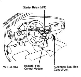

for the fans, if the fan motors, temperature switch, radiator and condenser fan relays and the oil temperature switch are all tested OK, i would suspect a faulty fan control module.

whee is it located so i know what to look for
Mar 25, 2010 at 12:40 PM
BLUELIGHTNIN6
  • 16,542 POSTS
behind the center of dash, on the right side of the heater assembly

GTOWNJOE
  • 13 POSTS
thanks I'll check it
