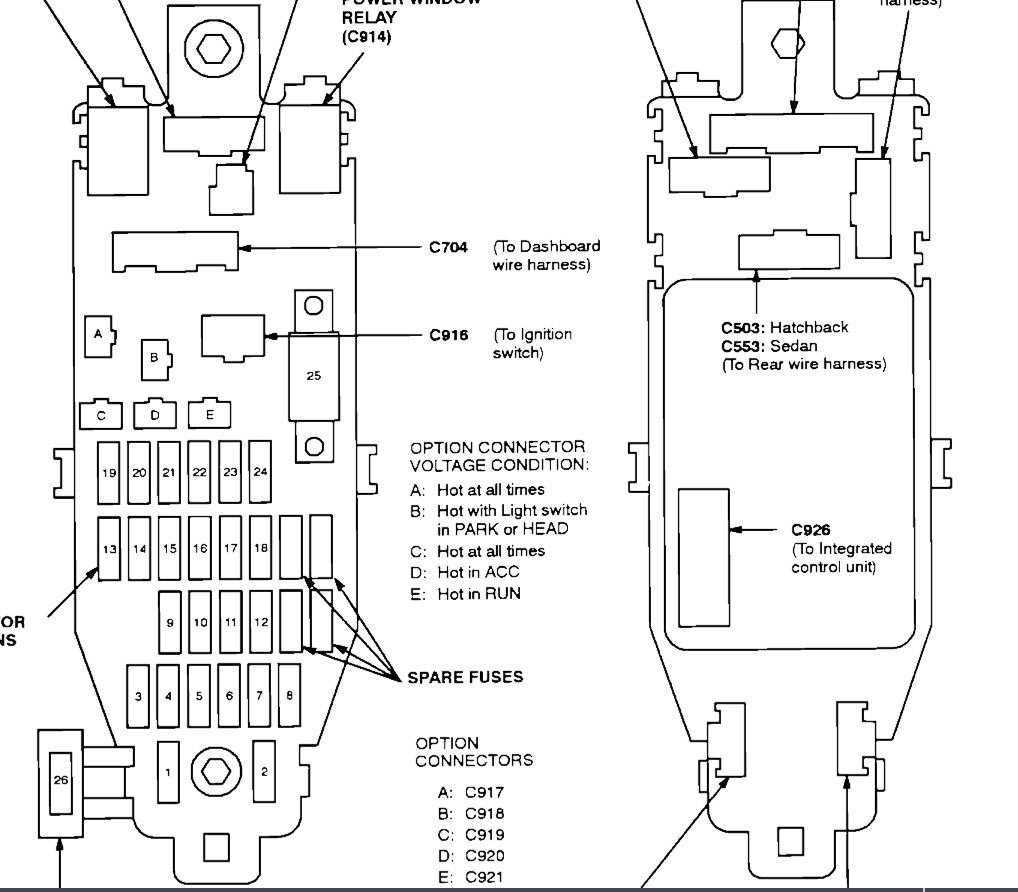

. For some reason, the cigarette lighter stop working. I thought it may be the fuse but I have no idea which one it would be. Could someone please tell me what could possibly be wrong and how to repair it. Thank you very much.
-Steve
Jun 10, 2009 at 5:55 AM
F4I_GUY
  • 3,302 POSTS

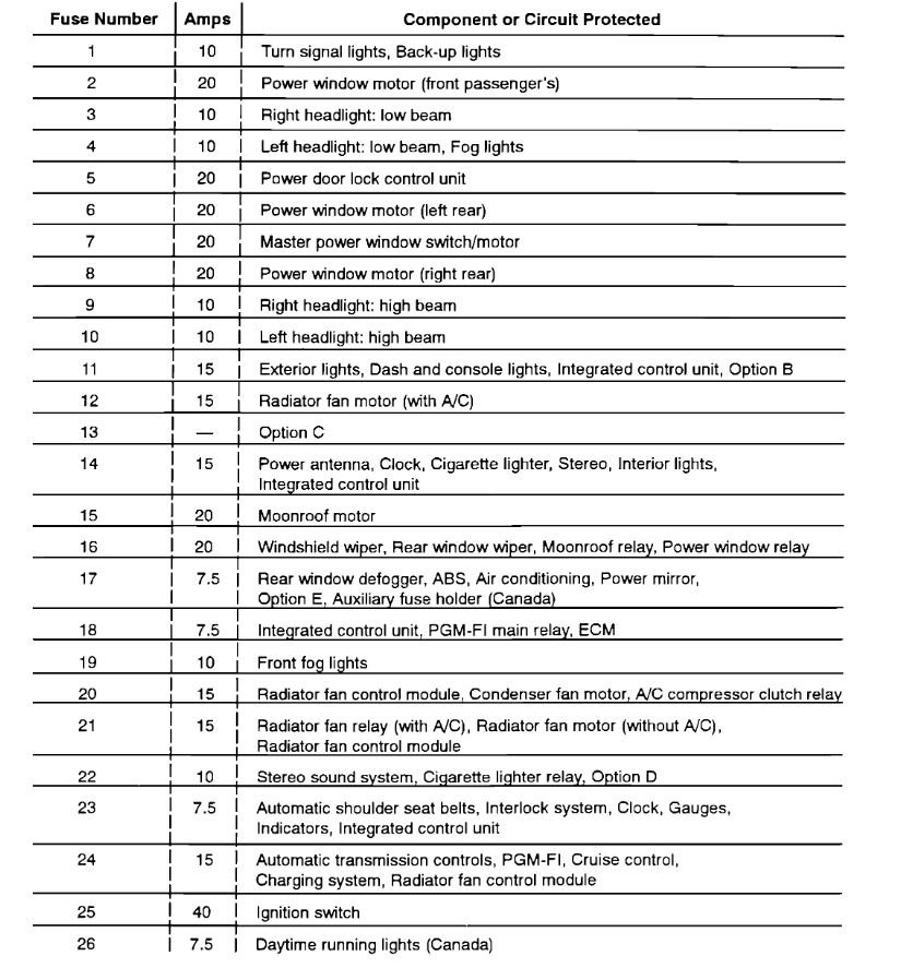

You are looking for fuse #22. its a 10 amp
See the guide below for testing fuses with a est light
Diagram of your fuse block is attached below
