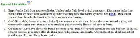

How do I take booster brake out orf 93 Integra? Do I have to remove intake manifold?

Remove the brake master cylinder and then unbolt the booster from the inside

See text for booster removal procedure. Mark (mhpautos)

Hi, on my '93 Integra, booster brake cannot come out, even I took out the master cylinder, 4 bolts on the booster cannot come all the way out and the booster is against the intake manifold. Any suggestion? Thanks
