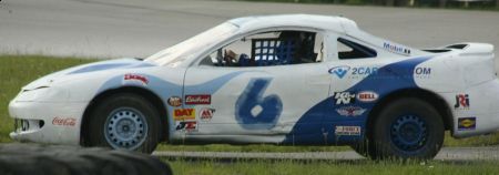

I am circle track racing a 92 integra with the 1.8l motor and five speed manual trans. I need more camber in my front tires, and I am looking at getting adjustable ball joints. Is there any other components I might need to change? I'm not looking to lower or raise the car.[img:5a43481ebc]http://www.2carpros.com/forum/automotive_pictures/448847_D69852D5_1.jpg[/img:5a43481ebc]

are you leaning the front passenger wheel inwards? if so you can cut and reweld the top control arm so it will pull in the wheel at the top. much cheaper than buying new ball joints but doesnt work on all cars. BTW i race at a local circle track too ;)
