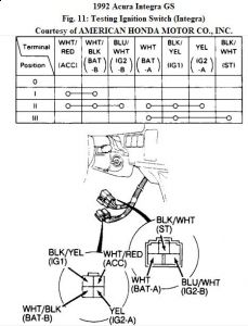

I have 92 acura integra. Ignition switch went bad and i replaced it. I started the the car a couple time and put every thing back together. After i put it back together i cant get it to start. i turn in key and only cd player comes on. No dash lights AT ALL come on and it seem not to even try to start. it just clicks. i checked all fuses and battery connection. Please help me out. Thanks

Hi Pnut654, There are a few possibilities for the problem. 1. Faulty ignition switch. The diagram shows how to test the ignition switch.
https://images.2carpros.com/forum/automotive_pictures/192750_IgnitionSwitchTest92Integra_1.jpg
2. Wrong switch. Terminals could be different from original. 3. Connector not securely connected to fuse box.

I wanted to thank you, for adding the test point guide for the ignition switch, it would be hard to check the ignition switch without it. I took apart the ignition switch, re-soldered the bad connection. and now it's working great.
