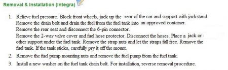

hey how u guys are doing i wanted to know i just brought the car and the fuel pump is not working i want to replace it and i want to know is there any guys can help me please i just had a son and i want to replace it myself because i cant afford a tec

Hello I'm good, how about yourself? Congrats. on your baby boy. Below are the replacement procedures for your vehicle's fuel pump. Let me know if you need further assistance with this repair.
https://images.2carpros.com/forum/automotive_pictures/261618_Noname_517.jpg
