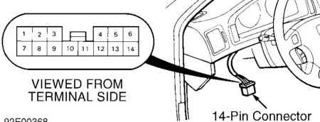

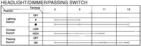

Test continuity and resistance to your multi-function switch. Suspect bad switch.

I've already tryed the switch no diffrence.I did find out that if you turn on the headlights and wiggle the switch a little and turn on the turn signal it works like it should.So I don't know what's wrong with it.I need this car running before the 24th.

[quote:7a4424d774]I have already tried a diffrent switch,but no diffrence.Which 14 pin plug did you say to check?The one that goes into the fuse box or the one that goes into the door lock control box? [/quote:7a4424d774]
I still maintain that the problem is due to bad multi-function switch. The entire light switch (turn signal stalk included). That is the only logic that explains the turn signal works when you wiggle the switch.
The 14-pin is the socket to the multi-function switch that runs the headlamps, turn signal, hazards...

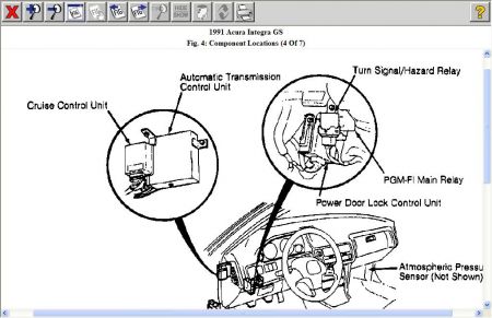

https://images.2carpros.com/forum/automotive_pictures/55316_fl34_3.jpg
This is your flasher. Responsible to create the "intermittent effect" to the turn signals and hazard lamps. Are you talking about the hazard lamps? If you are, then yes, it is a part of your problem.

Where is that located at?And if I replace that hazard relay and the multifunction light switch my problems should be solved?thanks
Apr 19, 2009 at 11:02 AM
ZACKMAN
  • 4,202 POSTS
The flasher should be by the steering column. My opinion is that replacing both the flasher and the multi-function switch should fix your problem.

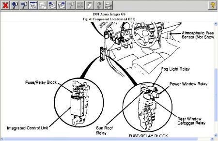

Check and test both the flasher and the intergrated control unit-see below
https://images.2carpros.com/forum/automotive_pictures/12900_flasher2_1.jpg
https://images.2carpros.com/forum/automotive_pictures/12900_ICU_1.jpg

Did you check the integrated control unit? It is plugged into the fuse box.

What I meant was to check if the unit is faulty. The turn signal circuit has to go through the integrated control unit as it incorporates a right and left flasher unit.
