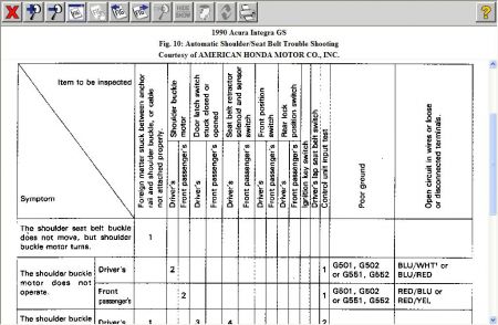

1990 Acura Integra
the motorized two-point passive shoulder belt will not move into place when the door closes. I would like to know if there is a way to manual move it back. driveing with only a lap belt now.
Dec 1, 2008 at 1:59 AM
KHLOW2008
  • 41,814 POSTS

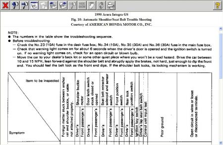

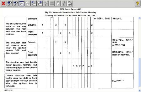

Hi garneau, I have attached a trouble shooting guide and hope it helps.
