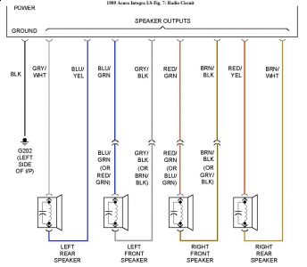

need help cant hook up my cd in my car because of my wiring can anybody think of something please need music lol[img:9488eea55d]http://www.2carpros.com/forum/automotive_pictures/435457_1258324633987_1.jpg[/img:9488eea55d]

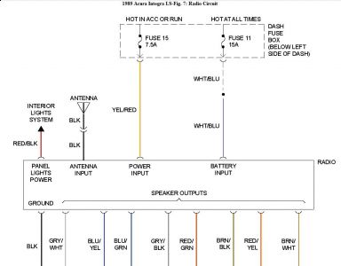

Hi acuraman276, So you are going to have fried octopus for dinner? What I offer is the wire harness color codes and where they lead to and the rest is up to up to get them connected correctly to get the sound system going. Here is a schematic of the radio wiring.
https://images.2carpros.com/forum/automotive_pictures/192750_Radio89IntegraFig07a_1.jpg
https://images.2carpros.com/forum/automotive_pictures/192750_Radio89IntegraFig07b_1.jpg
Good luck.
