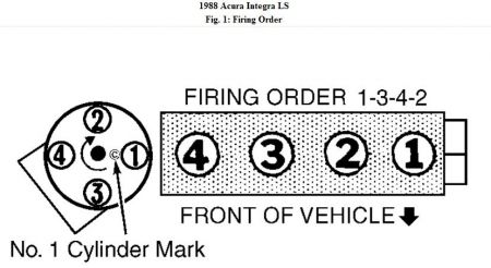

I Was changing the spark plugs on my Integra and when i restarted it, it sounds like its miss firing does anyone know what the position of wires in regards to which wire goes to which spark plug

Hi Scottq2009, Here is a diagram of the firing order.
https://images.2carpros.com/forum/automotive_pictures/192750_FiringOrder88Integra_1.jpg
