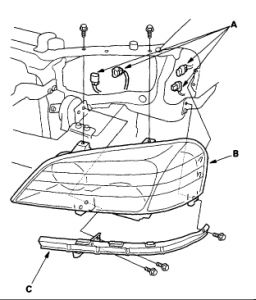

how to remove and replace both headlight assemblys

Headlight Replacement
Remove the front bumper.
https://www.2carpros.com/forum/automotive_pictures/12900_h_4.jpg
Disconnect the connectors (A) from the headlight (B).
Remove the five mounting bolts, then remove the corner upper beam (C) and headlight assembly.
Install in the reverse order of removal.
After replacement, adjust the headlights to local requirements.
