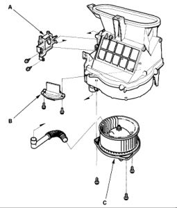

We just replaced the battery in our Acura and now the heater fan/ won't quit running. We can change the temp, but not turn on the A/C. Tried simply shutting off with the control and that doesn't work. Had to pull the fuse to gt it off.

Hello, if I understand you correctly, the blower fan for the AC/Heat will not shut off unless you pull the fan fuse? Have you checked the codes? Auto Zone and O'Reilly's does this for free. I think it may be the blower motor resistor. "B" in the pic
https://images.2carpros.com/forum/automotive_pictures/248015_Blower_1.jpg
