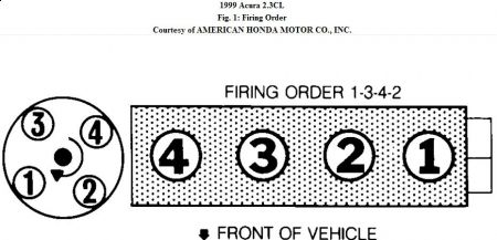

what is the correct wire order on cap?
Mar 8, 2009 at 4:31 AM
KHLOW2008
  • 41,814 POSTS
Hi John,
https://images.2carpros.com/forum/automotive_pictures/192750_FiringOrder99Acura23CL_2.jpg
