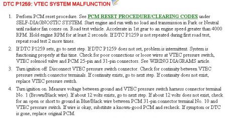

sorry i forgot password and i cant seem to be login no more a about my cl the light keeps poping out and when it does my car cant go over 4000 rpm but i reset it and when its off it goes over one time and then light pops out again and doesn't go over 4000 rpm 1259 code pops out with 1399 ..and then the other day it was running for a couple of minutes the light shut off by itself and it was fine for 2 days and did it again its weird ...sorry to keep posting ...how bad is it thanx, and about the gas it doesn't burn much more as before ,

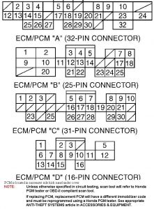

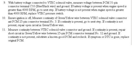

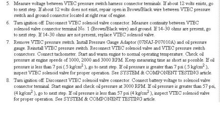

P1259 VTEC System Malfunction P1399 Random Misfire Fix P1259 first. It may fix your P1399 as well. Here is the diagnostic.
