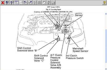

i got 97 acura cl v6(3.0) auto . i check all fluid. and already change the speed sensor. problem is when i put my car to drive or reverse . it is not moving. i have to rev up the rpm near 2000rpm . then it is move the car. on freeway it is run fine . the problem is only at when i put my car to drive and reverse

it happen in all gears.it happen all the time even when oprrating temputure is achieved.when shifting to 4th gear engine rpm flares.d4 light use to blink but after change odemeter speed sensor it is not blink .color o fluid is red.no check engine light on.yes it is delay upshift

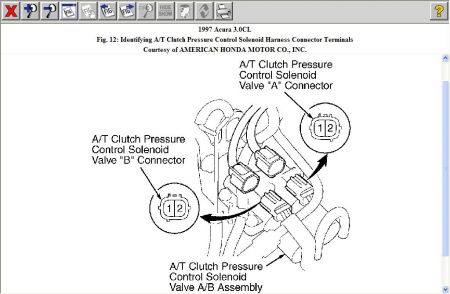

Hi bunty83, The symptoms shows lack of pressure causing the slippage and ! of the possible causes are the Clutch Pressure Control valve A and B. A/T CLUTCH PRESSURE CONTROL SOLENOID VALVE "A"/"B" ASSEMBLY 1. A/T clutch pressure control solenoid valve "A"/"B" assembly is located on transaxle. See Fig. 4 . Disconnect harness connector at A/T clutch pressure control solenoid valves "A" and "B". 2. Using a DVOM, measure resistance between solenoid terminals. Resistance should be about 5 ohms. Replace A/T clutch pressure control solenoid valve "A"/"B" assembly if resistance is not as specified. 3. Check A/T clutch pressure control solenoid operation. Apply battery voltage to terminal No. 1 and ground terminal No. 2. See Fig. 12 . A clicking sound should be heard for each solenoid, indicating solenoid operation. Replace A/T clutch pressure control solenoid valve "A"/"B" assembly if solenoid fails to operate.
