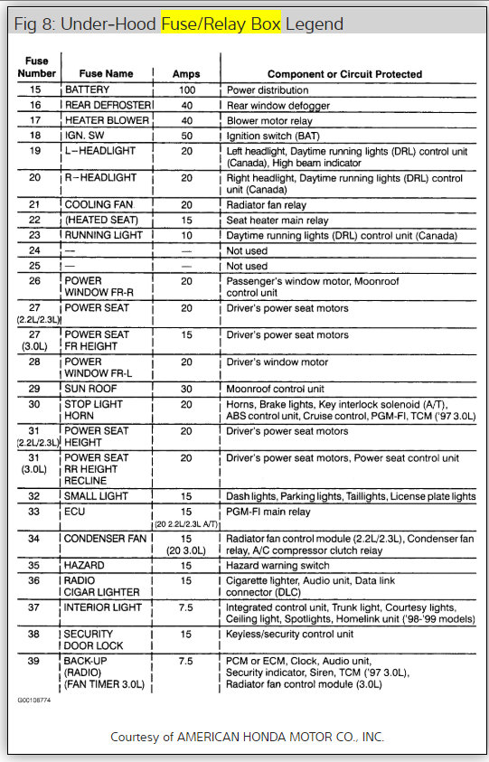

The interior ceiling Dome Light fuse and the Dash Board Light fuses are blown. Also whatever fuse that controls the rear night time running lights. I need to know which fuses to change so I can drive at night. I have the fuses to change them, but I don't know which ones to pull and replace.
Dec 23, 2009 at 6:17 PM
KHLOW2008
  • 41,814 POSTS
Hi GregB88n,

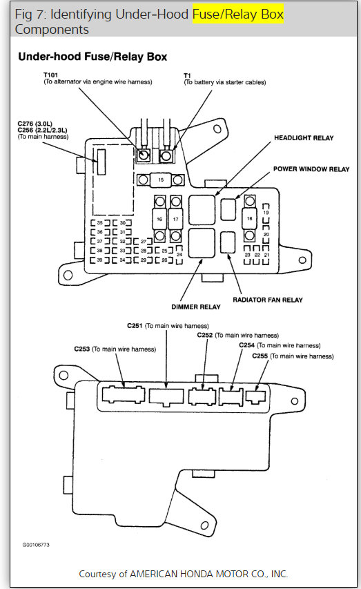

The fuse for the taillights and dome lights are in the underhood fuse box.
Fuse # 32 ( Small Lights )
Fuse # 37 ( Interior lights )

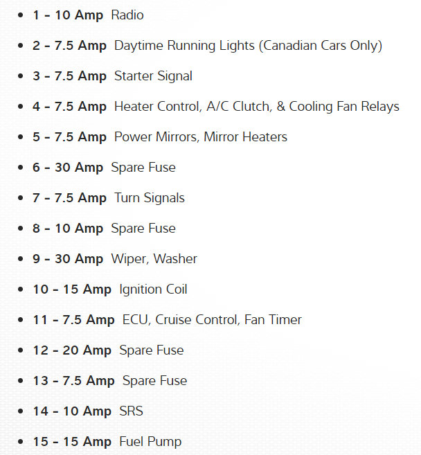

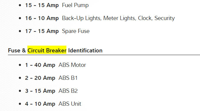

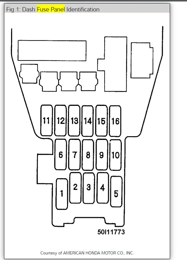

Here are all fuse location and a guide to help you check them.
