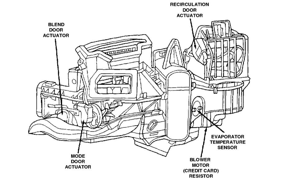

Changed thermostat got some warm air but then only cool air. Blower motor works fine. May try to blow out heater core but wondering where the actuator is located in case that is the problem

I would flush the heater core. use a garden hose to clear it. Run it both ways several times to get a good clean flow.
I attached a picture of the location of the blend door for you to view.

I intend when it warms up here to use both air and a garden hose and then pour a radiator flush into the heater core and let it sit for 1-2 hours and then flush it out. I will flush into a clear bottle to see what debris I might find. Then pour fresh coolant into the heater core, put the hoses back on and see if that was the problem. Not being a mechanic (some ability as I had a problem with no heat in my 2002 Silverado 2500HD and was able to replace the actuator and that solved my problem with it. What I want to know verbally is where is the actuator located in my wife's 2003 Dodge Dakota. The image you sent does not help that much. Thank you so very much for any assistance you can give me.l

The image shows the location. It is identified in the picture. It is under the dash toward the center of the truck by the air distribution vent for the floor.

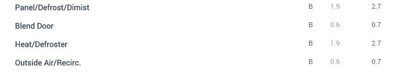

I do not want to really bother you but is there anyway you can detail what it takes to access it?
Jan 25, 2019 at 1:01 AM
Procedure below.
The labor in a shop is .7 hours or about 45 minutes from start to finish.

In my first response was the figure of the heater case with the parts identified.
