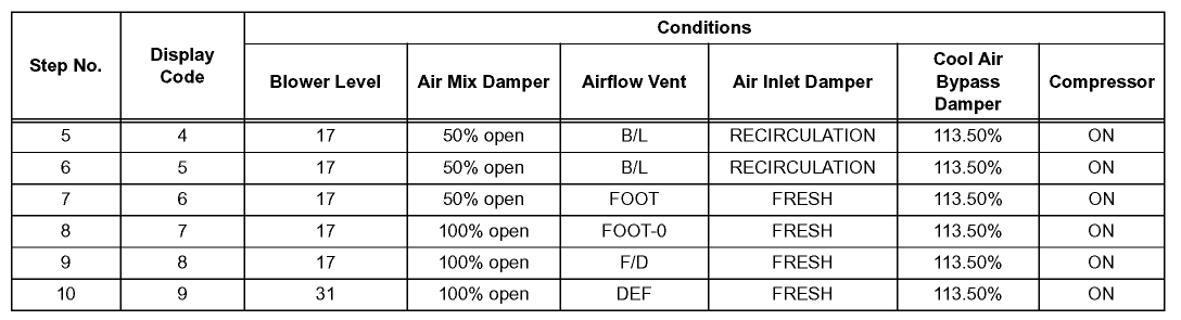

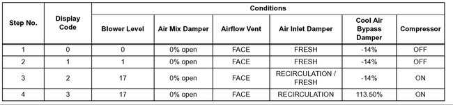

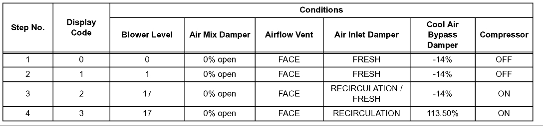

Hello, I am trying to find the fuse for the mode actuator. I was trying to reset system.
Apr 10, 2018 at 1:41 PM
STEVE W.
  • 15,238 POSTS
Unplugging the fuse will not reset that system, it takes a scan tool to make the system relearn the positions if they are replaced. You could try the actuator tests to verify which ones work or do not though. For that you hold down the A/C AUTO button and the Recirc/Fresh air buttons while you start the engine. Then watch the display as it operates the actuators and verify that the air is doing what it is supposed to do by feeling the various vents. To exit the testing mode press OFF.
