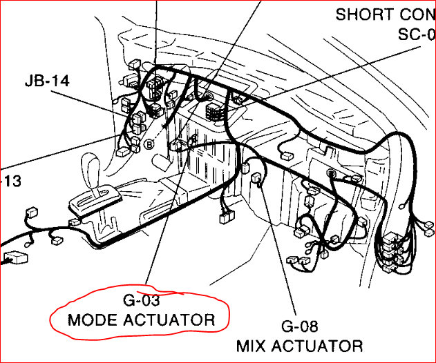

Can you help me locate the correct actuator door for my car? All other vents, airflow and temperatures work fine just the airflow to the defroster is not working. Finding anything for this car is a task. Thanks for your help.

I have attached a picture and circled it in red. It is behind center of dash, on bottom of HVAC unit. Hope this helps and feel free to ask any further questions if needed. Thanks for using 2CarPros.

Thanks Danny for the quick response. Will start this tomorrow.
